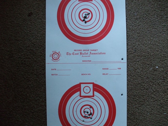

Top target is the first 10 shots from squeaky clean barrel (two fouling shots fired before test). These cast bullets have the “sorted gas checks” attached. Bullet bases inspected for a smooth level sprue plate cut. Bottom target is the second 10 shot group fired from a dirtier barrel (bore snake pulled thru barrel in between groups). These bullets have the "culled checks” attached. Bullet bases were not inspected. 45-45-10 lube used.

Powder charges were thrown using RCBS Uniflow with smaller pistol powder insert...this may be the reason for small vertical dispersion. Next test will involve hand weighed powder charges (6.8 grains) and CCI Bench Rest primers. I have been using Winchester small rifle primers.
