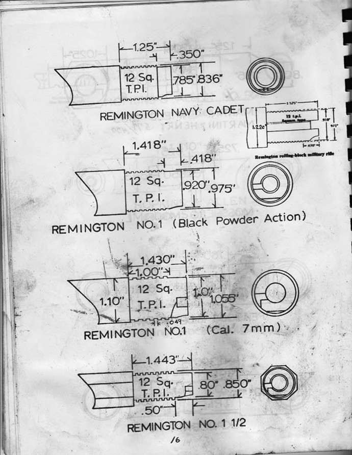

Tom Acheson posted this 08 December 2016
The fellow who will thread and chamber the barrel has not done a Rolling Block before. He has done a tone of smokeless bolt guns for BR and silhouette. Is there a drawing or some kind of resource that identifies the threads in the receiver or do those vary a lot depending on year of manufacture, etc.?
Thanks!
4060may posted this 09 December 2016
Single Shot Actions  Dehaas has all the thread dimensions in the back of the book
kendog posted this 09 December 2016
Thanks!
Tom Here you go. DeHaas calls it a No. 1 7MM in his drawing but it is actually the No. 5. All No. 5 shanks are larger diameter than No. 1's. Best to measure the barrel that comes out of it for working dimensions. Might have issues with the rotary extractor and the 38-55 rimmed case.
Tom Acheson posted this 09 December 2016
Kendog,
That is good. Should be enough to get us started! Good suggestion to study the removed existing barrel.
Thanks!
