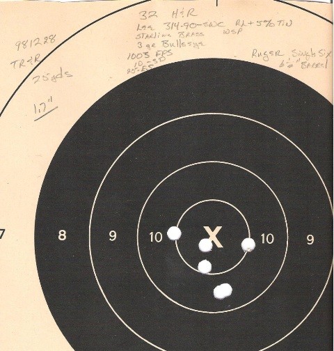

I've shot thousands of TL314-90-SWCs through several different 32 H&R magnums (S&W, Ruger and TCs) and 32 S&WLs. That bullet is my most used .32 caliber bullet. Fortunately I have a lee 6 cavity mould for that bullet.
Cast of RL and COWW with enough tin added for good fill out of the small drive bands I find the bullet drop at .315 +/-. Simply lubed and shot “as cast” I've found they chamber and shoot fine in S&Ws but with Starline brass chambering problems arise in my Ruger SS (original run) and my Contender barrel.
If lubed (as per the instructions) with LLA and pushed through the Lee .314 sizer chambering problems are eliminated in all. I've found both my Ruger SS and the Contender prefer the bullets sized at .312. The SS Ruger's cylinder throats pin gauge at .311 and the bore at .303.
In Starline 32 Magnum cases I load them over 3.2 gr Bullseye for 1000 fps and excellent accuracy out of both the Ruger and Contender.

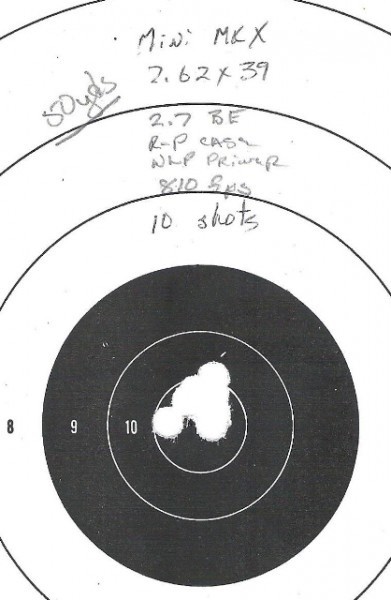

BTW; the TL314-90-SWC cand be lubed and then loaded in most milsurp .31s (7.65s, 7.7s, 303s and 7.62s) over 3.2 gr BE for an excellent plinking and small game/vermin load. Also lubed first and sized to .314 they can then be sized through a .311 Lee sizer (I sized base first to keep the base square) for use in .30 cal rifle cartridges. A load of 2.7 gr is excellent up through 300 Savage case capacity and 3.2 gr BE is excellent for use in .30W up through 30-06 size cases. No wad or filler is necessary.

If the alloy is soft and you are sizing down a bit (like from .314 - .311) through a push through the alloy has to go some where. The sizer has a taper to the actual sizing diameter and the push rod is usually not a precise fit. Thus the alloy can be swaged back over the push rod leaving an uneven base. The BB on my TL314-90-SWCs is totally swaged away on sizing down to .311. Sizing the small TL bullets base first solves the problem leaving a flat square base on the bullet. Here's 10 shots at 50 yards from my Mini MKX 7.62x39 with the TL90s sized at .312. LMG
