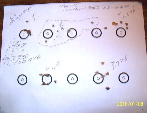

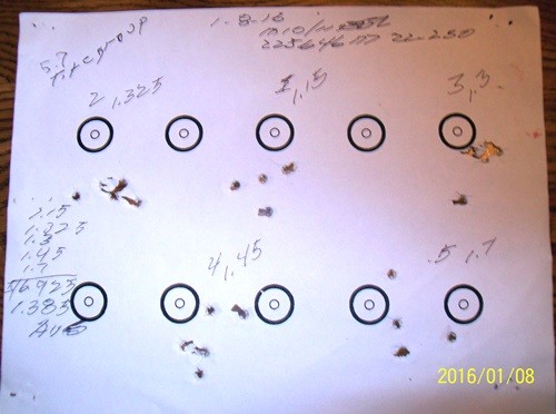

I got the $50 delivered Savage 22-250 barrel, took out a lot of copper, got it clean and screwed it on to a Savage M10. This is a 22” sporter barrel, kind of wispy.   On 1/6/16 I shot it with ammunition I'd loaded for the Striker. 225646M, unsized, GC, LLA, Titegroup 5 five shot 100 yard groups, got scope adjusted 6.0 grains avg 1.87" 7.0 grains avg 2.57"   1/8/16 225646M, unsized, GC, LLA, Titegroup 5 five shot 100 yard groups Set up targets l-r sighter, 5.7 gr., 6.0 gr. 6.3 gr. I shot 5 sighters to get going, went to the far right target, 6.3 gr, and shot a 3.8” group.   Alternated targets, 6.3, 6.0, 5.7, 6.3”¦back and forth   5.7 gr avg 1.385" 6.0 gr avg 1.44" 6.3 gr avg 1.89", without the 3.8” group, 1.413"   This is the best day I've had with a 22 cf in over 3 years of working on it.

Ken Campbell Iowa posted this 09 January 2016
looks like you are beating the 2 moa threshold, joeb ... sure wish we knew what happened in that 4 inch group ...
and real happy that you got a 22-250 working better than average .... especially with a small pinch of titegroup ....
now you have something reliable enough to test some common sense ideas with ...

So, unless it falls apart, it looks like this old cheap barrel will shoot < 2", maybe < 1.5".
What do I change to get it shooting better?
Bullets from a 2 cavity mold, visually inspected under 3X magnification, not weighed. GC crimped on in 450, LLA with mineral spirits. Hornady brass, chamfered in, not trimmed, not neck turned, no primer pocket uniforming, no flash hole deburred, not weighed. After firing, deprimed, inside neck wiped with Q tip and Marvel Mystery Oil, FL sized in RCBS dies, Lyman M died so GC goes in case mouth, inside neck wiped clean with Q tip. Powder dropped with Lyman 55 after setting with a scale, powder checked with flashlight. Bullets seated with RCBS die, each bullet wiped with LLA/mineral spirits = thinned, with fingers. Weaver T36, Hoppes $30 rest, ~1970,  with sandbag, good rear sandbag.

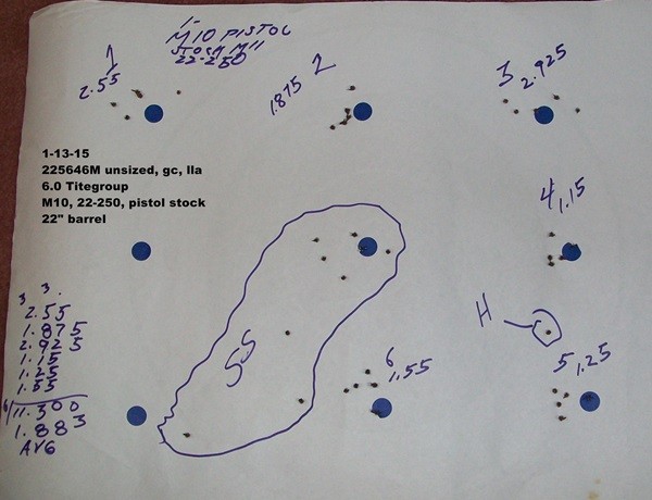

joeb33050 posted this 13 January 2016
BR SETUP
TARGET
Ken Campbell Iowa posted this 13 January 2016
funny that the ” fliers ” in your 2 plus inch groups all went to the right . vibration ?
ready to try one of those ugly barrel tuners ??
ken, who likes to read things into directional groups ...
