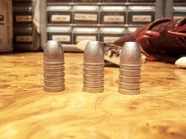

A sample of my bullets..These are .458 so it's getting there... One thing I realize that I was doing was putting the spru right back into the pot, right from the mold....

Your bullets in the picture have excellent sharp fill-out and some frost. You may not be able to get them bigger from that particular mold. Saving your sprues till you start a casting session and increasing your cadence plus the other tips  can bring your mold temperature up 50 degrees without any change in your pot setting.
