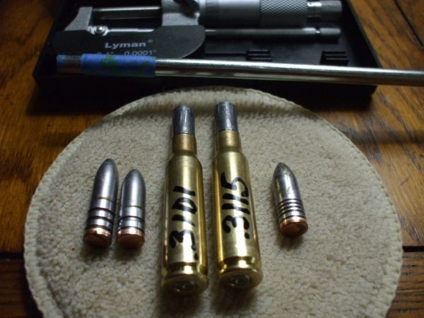

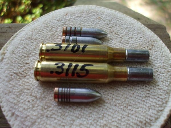

Today I finally did a pound cast to measure the freebore diameter of both my Remington 700 rifles chambered in 308 Winchester. First I filled two fired cases with mixed epoxy (Pacer brand finishing resin mixed 50/50 in Dixie cup) then hand seated a pure lead bullet in each case. Waited about 4 hours for epoxy to cure then chambered bullets. I use a 1/4” steel rod with tape wrapped around it as a guide and to pretect rifling and a rubber mallet to pound bullet to fit chamber.     The Remington 700 Varmimt Sythetic chamber free bore measured .3115     The new Shillen barrel with minimum SAMMI chamber free bore measured .3101     Now I can size bullets to fit more accurately. What diameters do you guys recommend? I hear .0001 -.0005 under is best.       Gas checks are a real nuisance, can a non gas checked bullet shoot just as accurately as a gas checked bullet.
OU812 posted this 03 September 2014
The Remington 700 VS with its larger .3115 NATO chamber will shoot most all bullets pretty good if they are sized .3113 and really loves the Harris design Lee 160 bullet with taper nose section.   The tighter Shillen barreled gun really likes good fitting bore ride bullets, the RCBS 165 sil and Lyman 314299 sized .3095.   I size bore ride section using a Redding .301 and .302 neck sizer die bushing resting on top of Lubramatic .358 size die installed. I turned down matching nose punches outer diameter from .303 to .300 so I can flip bullet over and press bullet back thru neck bushing after sizing nose.    I size bullet bands and seat gas check dry so that gas check gets better grip, then I hand dip bullets in Alox thinned with mineral spirits and set bullets on wax paper (on their bases) to dry overnight.  This lube method seems to work pretty good without having to clean too often. Is there a better lube.....SPG?

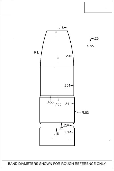

Here is one design I edited more to my liking.

That will help with the 12 twist. I would skip the ALOX too. I would look into a good dip lube. I would also use a push through sizer as to not damage the base. That is critical on a flat base. Tom cuts very good molds. It will come out exactly like you want. Just make sure to let him know the exact alloy you plan to use.

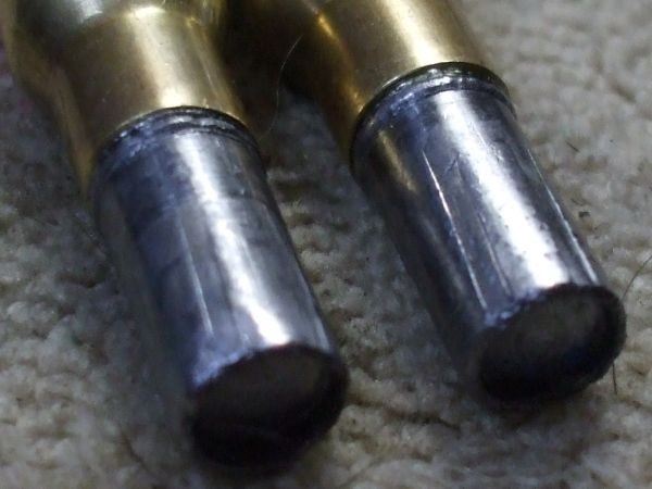

Here is a better picture to show you the freebore length. The Factory Remington has a much longer 308 NATO length, about double the length of minimum SAMMI chamber length of .090   308 NATO left..............308 minimum SAMMI right. Notice the Remington barrel on left has more narrow .040 wide rifling lands. The Shillen's rifling lands measures .060 wide.    The chamber cast really helps you understand why some cast bullet designs will work better than others. I can easily see why the larger Remington throat likes the LEE 160gr bullet with its .312 wide base and tapered nose.
