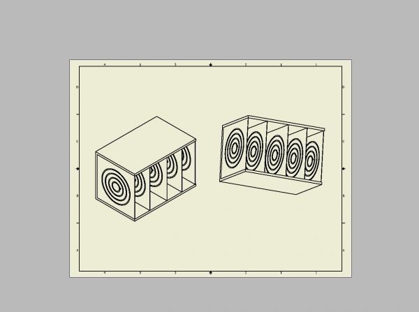

<user=50>RicinYakima wrote: Joe, There was a reason I asked for the best 10-shot group on the other thread. That is the reason I view five 5-shot groups as being less revealing. Ric Ric, what if we made a box like this, that holds a number of targets. Then we shot at the front target. Every 2 shots we remove and replace the 2nd with a new target.Every 3 shots we remove and replace the 3rd with a new target.Every 4....And so on.Each and every shot goes through each target.After a zillion shots we've got stacks of 2 shot, 3 shot, 4 shot, 5 shot,...10 shot targets.We measure each target and average group sizes.3 shot avg > 2 shot etc, the average group size increases as the number of shots. 10 shot groups are larger than 5 shot. It doesn't matter(much) how many shots are on a target. If we know the averages from our stacks of targets, we know that 7 shot groups are 1.43 times the size of 3 shot targets. NO NUMBER OF SHOTS PER GROUP IS “BETTER” THAN ANOTHER!.jpg?width=690&upscale=false” alt=)

JOE, I like the box! Shoot 5 shots at the first target then take it off. Shoot 5 at the second target, take it off. Shoot 5 at the third target, take it off. Shoot 5 at the forth target, take it off. Shoot 5 at the fifth target and measure it.

RicI don't understand what you wrote.Removing and replacing targets in the box after, say, 50 shots would give us 25 2 shot, 16 3 shot, 12 4 shot, 10 5 shot, 8 6 shot, 7 7 shot, 6 8 shot, 5 9 shot and 5 10 shot targets-all shot with 50 shots. What is this about only measuring the fifth target?

Note that the box eliminates this effect.
