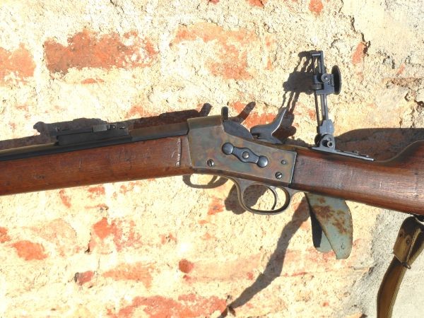

Yes my Modelo Argentino Rolling block has this kind of form , it is like _a long gradual throat. A civilian Swiss Martini has the same shape of chamber. The chambers of those ancient cartridge cartridges cannot be compared with the modern chambers. I do not look for bench rest accuracy from such ancient & obsolete smoke poles, I have generously fat custom bullets from an LBT mould ,pour a prudent 45/70 Trapdoor load and have at it. Pardon me I shoot for fun at 60 yards gongs , from offhand.

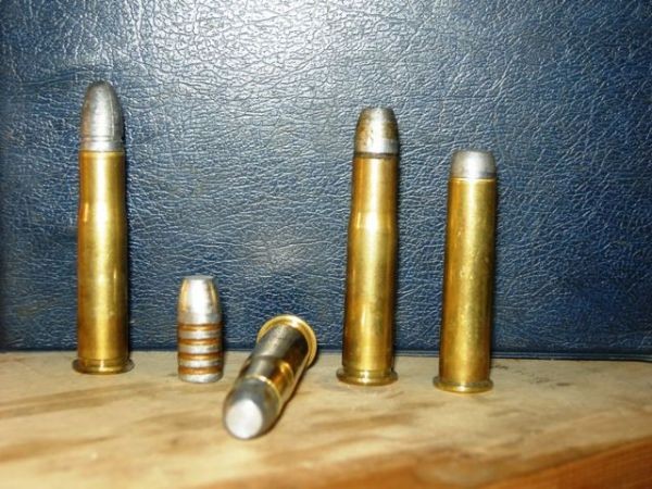

In the picture you can see the Lyman 43 Spanish  bullet , the LBT bullet and a 45/70 LBT  400 gr  Marlin bullet. Just no hope to touch the 43 Sp rifling wit the bullet nose. A concept not considerated in the pampas or San Juan Hill by the black powder shooting Latino infantrymen. A thing you can do in the modern marlin rifle.   The gongs are awaiting for execution at Acqui Terme.

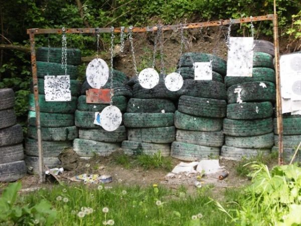

hi giorgio ... hey that photo of your gongs is very inspiring ... i may make a poster of it and hang it over my loading bench !!
i love the holes in the frame !!
a work of art !! or a work of giorgio ... bet you didn't do much of those misses tho ( g ) .
giorgio de galleani posted this 14 May 2014
Real man shoot standing on the rear feet, and the rifles are shot a lot before zeroing. The poor frame stands proudly under a hail of fire. I got fed up ,or burned out from shooting small groups on paper, if the shots do not hit steel,we advance to the targets  for zeroing in . We practice fun shooting. As Mr Ruger used to say about accuracy : enough for farm boys shooting tin cans.
