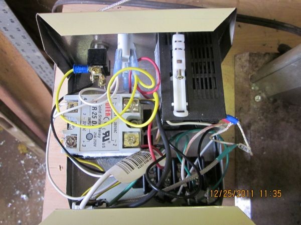

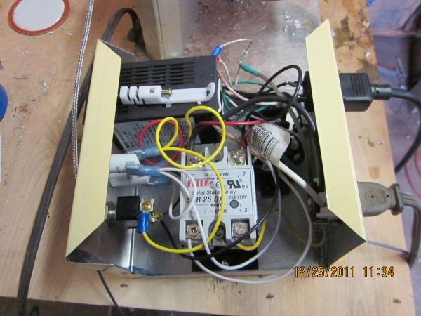

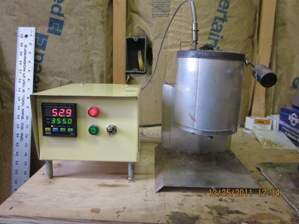

Uncle Russ can fix you up & you can't go wrong with a PID. Once you find the sweet spot for it you're home free. I made mine for about $50.00 in parts from ebay. You could too but if you are not comfortable with making one then look up Uncle Russ. I think he gives a choice of using all USA parts or Import parts. Pat.jpg?width=690&upscale=false” alt=)

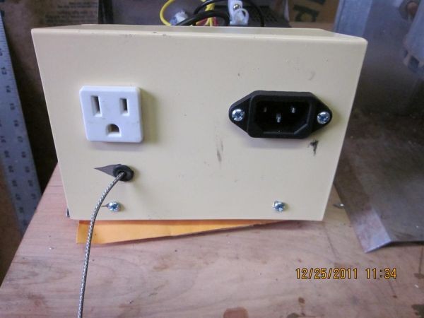

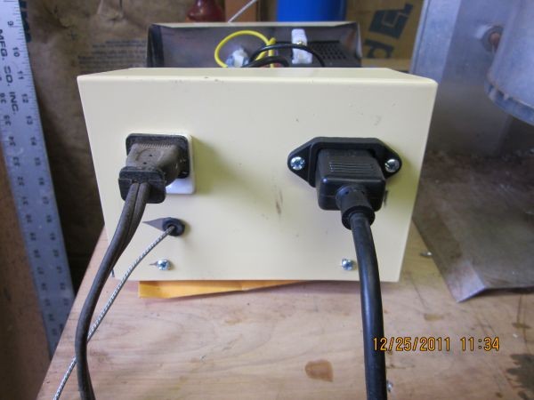

Another pic. The standard 3 - prong outlet on the left is of course for the pot to plug into. I had a number of computer cords laying around so I picked up a 3 - pin socket (on the right) for one of them to actually power the PID. Both of these parts are available on ebay for about $2.00 shipped each..jpg?width=690&upscale=false” alt=)

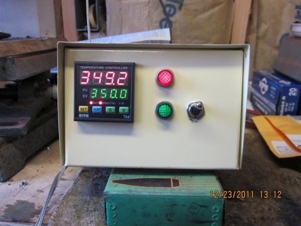

Another. A switch is actually optional as with the idiot lights. In this case I used a on-off-on switch. In the bottom position the green light stays on & the PID is bypassed leaving the pot to be controlled by it's own thermostat. Middle position is of course “off". Uppermost position puts the PID in control (Pot thermostat wide open). Again the green indicator shows the unit is powered up & the red showing that the PID is in operation. As the pot approaches the set temperature it will begin to cycle on & off with the red light flashing in unison with the opening & closing of the solid state relay (SSR). You'll note that my PID is set for 355 degrees centigrade (671F). I have since found that my “sweet spot” is 345 degrees centigrade (653F). I had just turned the PID on when I took this pic. The PID is showing the pot temp to be 52.9 degrees centigrade (127.22F). Yes, my PID registers in Centigrade only. No big deal as a conversion chart is readily available online..jpg?width=690&upscale=false” alt=)

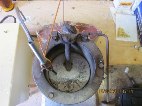

Another. Note that I used some (TIG) welding rod to make a holder for the probe. Still using the same one two years later..jpg?width=690&upscale=false” alt=)

Thanks for the pictures Pat, that looks like point to point wiring with 1/4” crimp on connectors and the cutouts in the project box probably took the most time!!!! The Lee pot itself is 500 watts so 14 ga. wire would be fine.

I made the cutouts in the sheet metal with my Dremel tool & a cutoff wheel, finishing up with a fine file. As I had mentioned I made the enclosure out of sheet metal left over from installing my new furnace. I have this cool little (18") sheet metal brake that I bought from grizzly industrial (for cheap like I am) to make my bends with. #14GA wire is more than big enough. Your pot at 750 wats will only draw 6.25A. #14 GA is good for 15A. You may want to size down a little.
I actually keep a number of 25' rolls of 18 ga. tinned project wire in my little shop for situations like this. The tinned wire (18GA) in “free air” is good for about 15A. I get that tinned wire from McMaster-Carr online.
Pat
