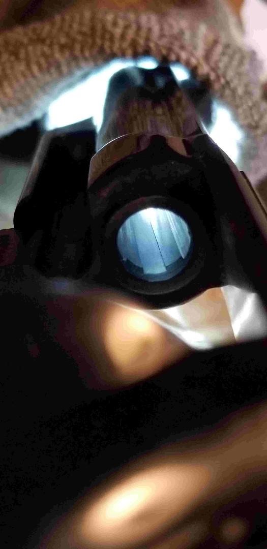

For me Eds red and chore boy wrapped on a cleaning brush work the fastest with the least effort. The lewis lead remover works but costs more. The pics show a S&W .357 after firing just 3 rounds of older hi velocity lead ammo. I was surprised at how easily it cleaned up with the combo listed above. Maybe because the lead was so soft? This method also worked quite well on a 30-40 Krag that had bad copper and cupro nickle fouling. I picked up a newer product called "big 45 frontier metal cleaner" It looks like a silver scrubber pad. It is supposed to work well on lead fouled bores.  I have not used it enough to recommend it yet. It did remove light rust without removing the bluing on a pellet rifle.
