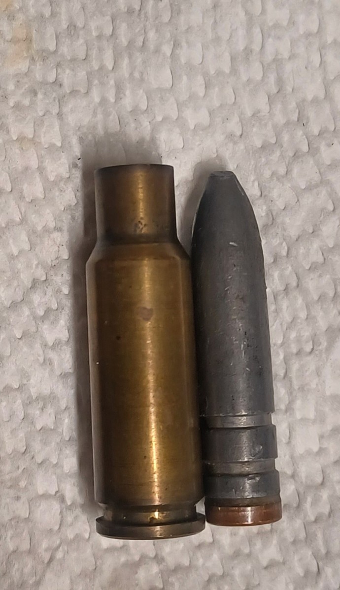

Max if your Ruger wears a factory barrel I'm pretty sure it'd be a 10 twist for the 06. I played with long 30 cal bullets years ago. It took me 3 Dave Mos molds until I got one to shoot. I started with a 1.425  260 gr. mold and worked my way down. I think the final one was 235 grs. but I dont remember how long it was. I was shooting these long bullets in a 30ppc case out of my bench gun im a Shilen 10 twist with a 3/4 degree incl throat and taper die. I did set a 200 yard 5 shot group record with it but moved on to something else shortly afterwards. Here's a picture of the 260 grain bullet next to the 30ppc case I shot it in.
max503 posted this 29 May 2025
Thanks for the post and the pics.
Maybe there's hope.
Someone wrote on the manual,"1:11 or 1:12 twist".  I haven't measured it myself.
