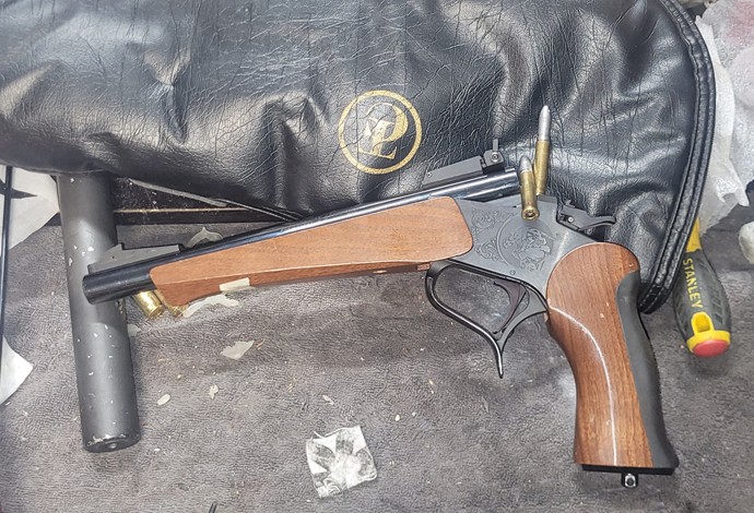

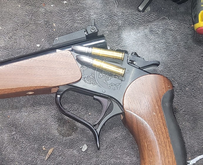

Barrel just arrived. It slugs. 308 x .301.Its throated pretty long and the 180sp RCBS and Lee Harris bullet chsmber fine at .310
Somewhere I had loads for long bullets like these but don't remember where.
looking for the old IHMSA crowd to speak up with advice.

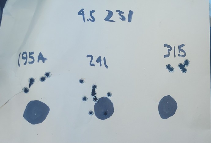

4.2 HP38 with SAECO #315 very mild and shot about 1" at 50'.
10.5 H110 with RCBS 180SP was stout and shot about 2" at 50'.Pressures seemed fine.
Light was pretty poor and I had trouble seeing the sights.The gun as I'd assumed shot over 16" high

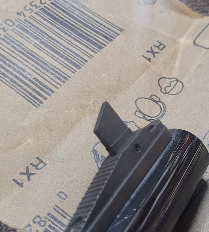

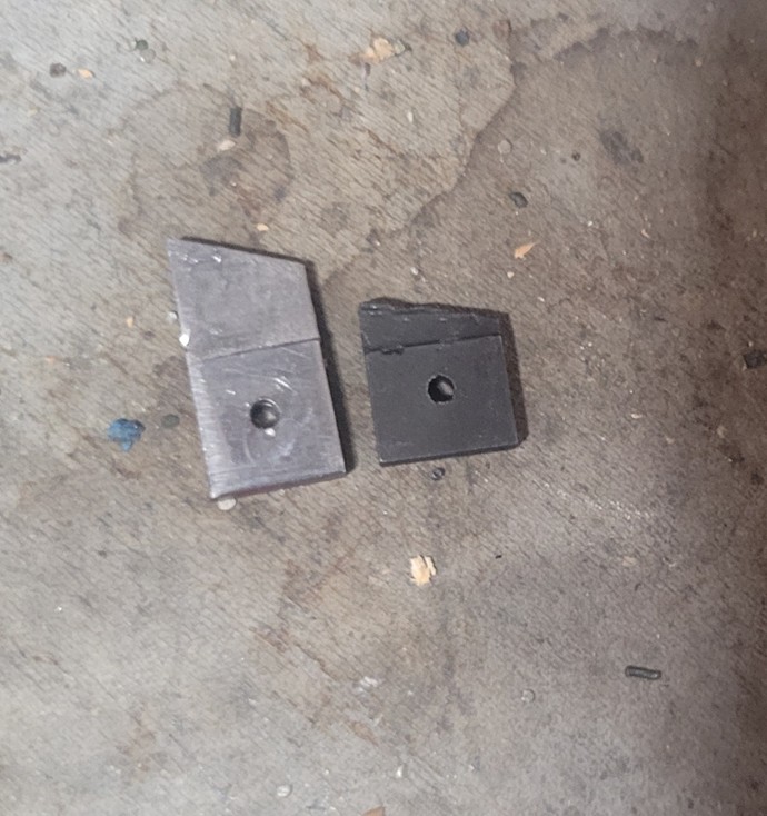

my 50' groups were 16" above POI with sight near bottom as mentioned above .I made a new front blade this evening on the little Sherline mill.I left  room to file to get closer.

It Was windy and I got too lazy to shoot outside. I went back to the 50' indoor range and after filing around a bit I got close enough to where I want to be with the new front sight. I shot one group with each of the bullets i had left after the adjustments. I have a heck of a time with lighting in that dungeon of an indoor range.

Aaron posted this 04 April 2025
Yup. That front sight is taaaaallll.
