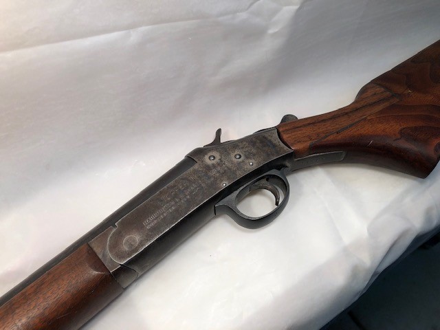

Wineman posted this 06 August 2024

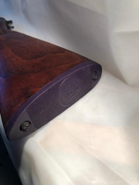

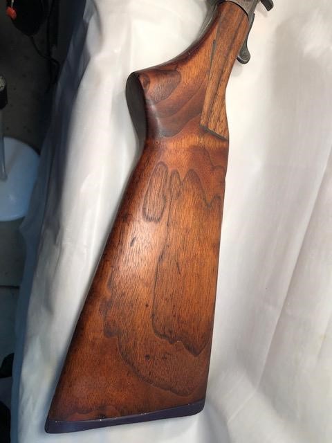

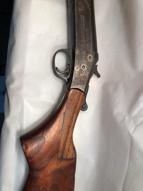

Well eight months later and here we are. Just to refresh, the left cheek wing was gone. Missing parts and where I got them plus price and shipping were firing pin spring (Gun Repair Center $14); Walnut 1/2"x2"x12" ($20); stock bolt (12-24 all thread, nuts and lock washer ($10); butt plate and screws (NC Ordinance $30); forend catch (ebay $20). Miscellaneous:  Watco Dark Walnut Stain, Acraglass, sandpaper, probably another $40. Yes this is a lot for a gun that might fetch $150 if in good condition (it is a 16 gauge so some premium?). However it is not an 1892 Winchester and getting dirty and finding ways and parts that did not break the bank gave me some valuable experience.
The metal got disassembled and boiled in distilled water for an hour, any rust got more oxygen and was then removed with steel wool and used motor oil.
I cut a piece of walnut and glass bedded it into place and the action too.  Even with a ton of modeling clay, painters tape and Kiwi neutral shoe polish, the Acraglass still found a way to grab something. I had to use a heavy brass punch to seperate things. Lots of sanding and chisel work later it got pretty close. The Watco dark Walnut did not do what I expected and I probably should have done more staining to color match. That side of the stock had some water damage and it will not come out. The butt joint is not too cool and in the future maybe doing a lap joint might be better. The butt plate and screws are a reproduction and it did require some filing and sanding to get a good fit.
Overall I am pretty happy and the next step is to see how it shoots. Strangely the tang is slightly bent and since it is a cast piece, I am at a loss to see how that could happen.
Dave
