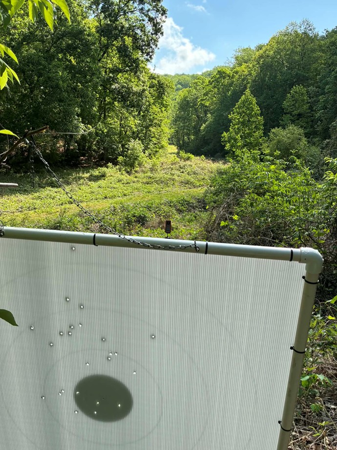

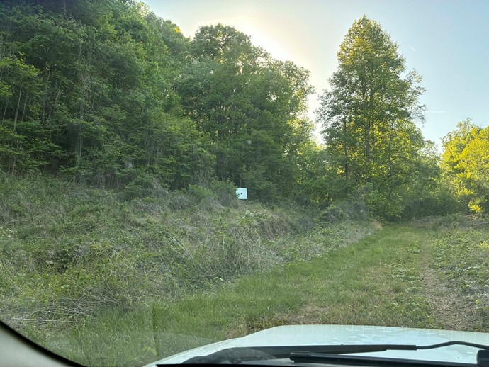

Gonna bring it down some next time...
300 yards
1,350fps
details: https://sites.google.com/view/44winchester/targets/targets-load-development/2026-targets

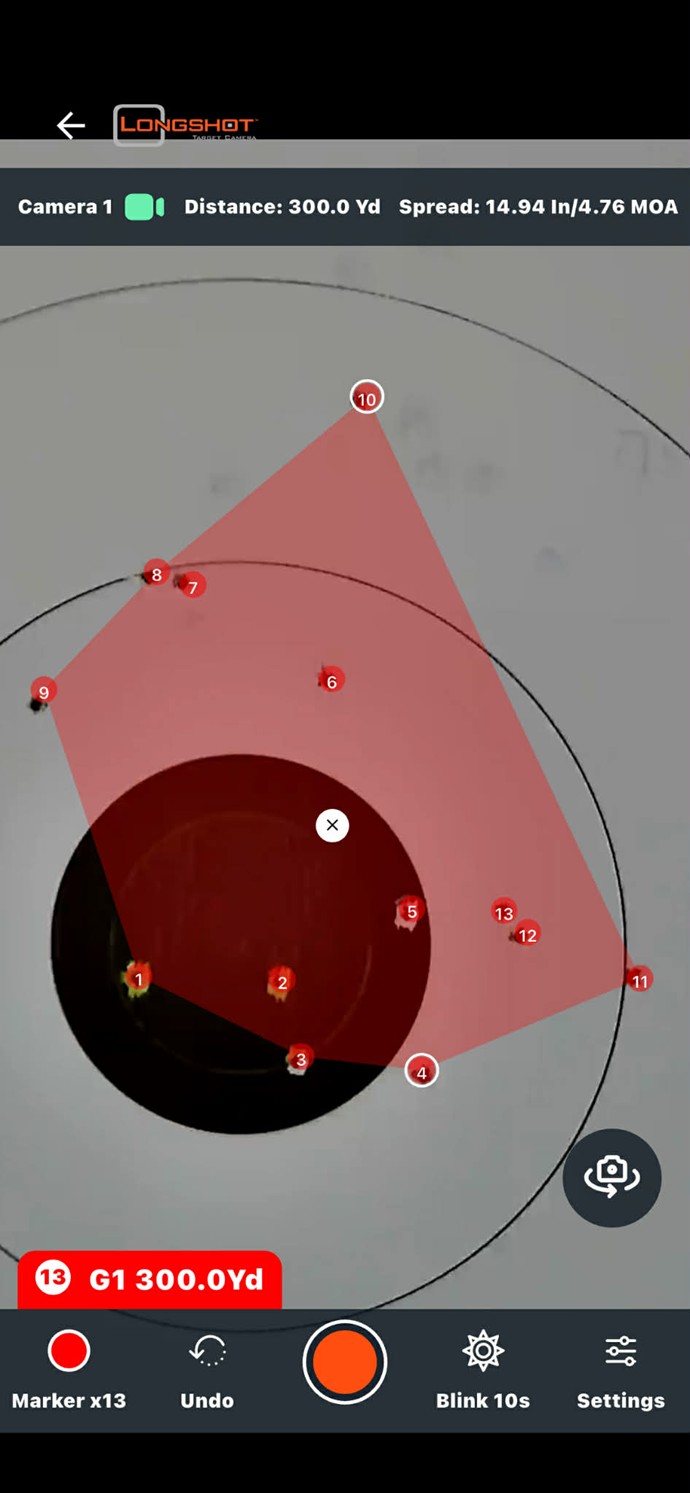

Bryan Austin posted this 26 April 2026
This morning, walked it up, adjusted the scope....then let lose on the barrage
numbers do not represent shot sequence.
last shots fired were...5,3,8,7,9,65,3,8,7,9,6

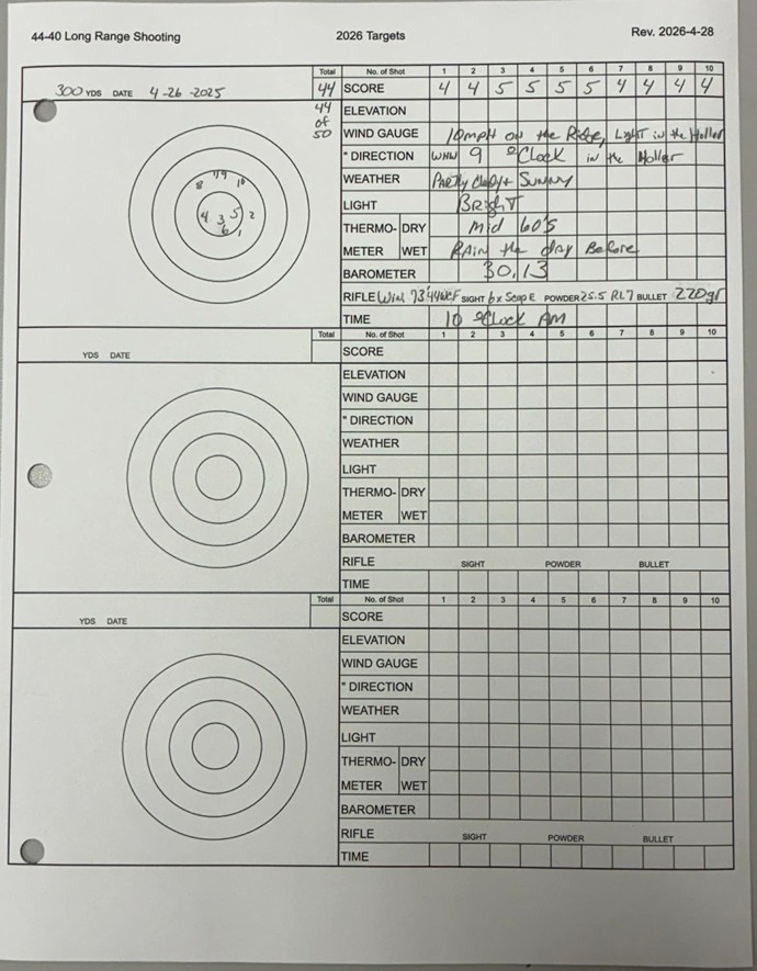

Bryan Austin posted this 28 April 2026
1870's score card

oscarflytyer posted this 02 May 2026
Bryan
Do you have a source or URL for that scorecard?  Thanx
Bryan Austin posted this 02 May 2026
I do let me get home on my desktop and I’ll post the link. I can’t do anything from my phone. I’ll also post a new Target from this morning.
oscarflyter, you guys may have to help me here. Here is the link to the sheet. I will have to select download in the upper left under "file". Download in the file format of your desire. Let me know if it does not work and I will try and make it work.
 Make sure you select the BLANK sheet tab at the bottom of the page first!
https://docs.google.com/spreadsheets/d/1U_BVhO69aIdQPl1icis4yt6Q4tI4KJDGDpVPSuEcn7k/edit?gid=857299821#gid=857299821

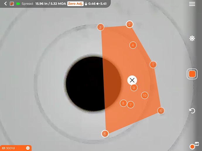

This morning's target did very well. The groups are consistent, and it is time to bring the group left a tad for tomorrow mornings sesson.
Unfortunately the video did not have sound, I will upload it later.
shot numbers are in sequence

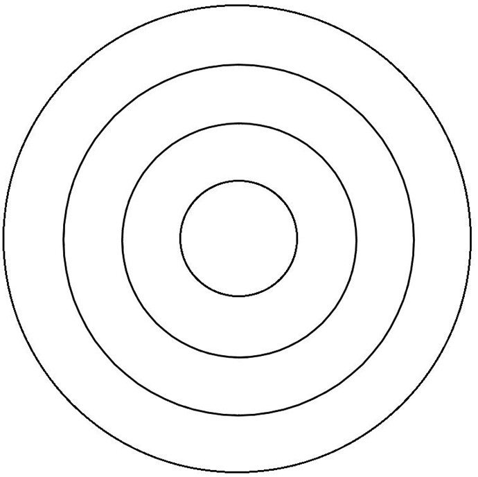

oscarflytyer posted this 04 May 2026
 Bryan
I am able to download the file in Excel.  All good - EXCEPT - in the blank tab, I get everything except the 5 ring target.  Not sure how you have that set up.  If I can get it all in Excel, AND that target ring - I am off to the races.  I know, in Excel, it may something special you built the file with that I am just not aware of.  Feel free to pm me if that is better.  Sure we can figure it out!  Thanx

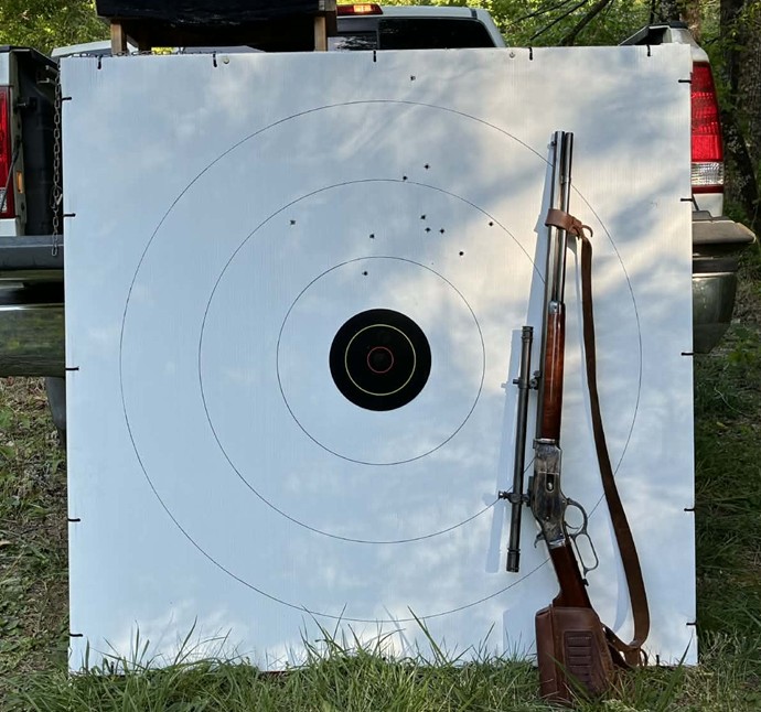

Bryan Austin posted this 04 May 2026
Good report Lance!!!
Yesterday's target was a bit better with the shots pulling left with a slight scope adjustment. Now if I could just the the vertical string fixed. I do believe that will be the results of the Reloder 7 and weather.

Larry Gibson posted this 04 May 2026
Score sheet copied good for me.

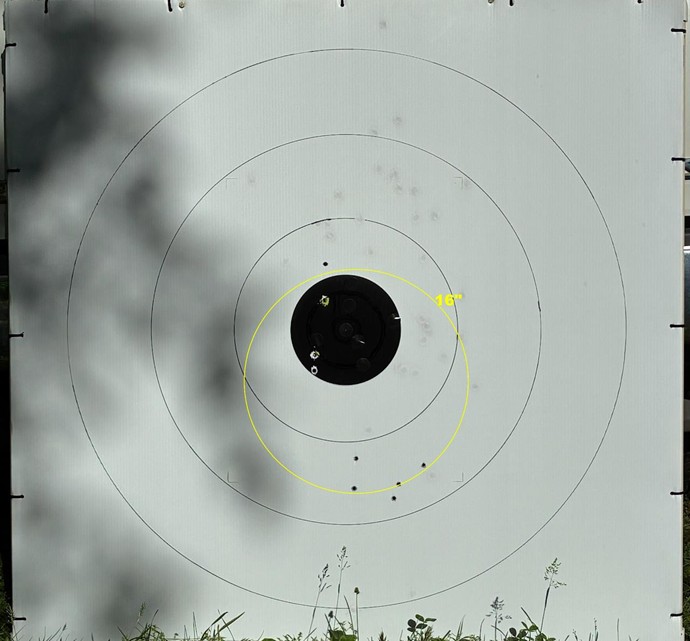

Assuming the score rings represent the 1874 #1 target with 8" bull?
That is correct Larry, thanks for the heads up!
Bullseye is 8", inner ring is 16", middle ring is 28" and outer ring is 40"
Target was used at 200 and 300 yards from what I read.
That's the one I figured it was....not sure I'm goona see an 8" bull at 300 yards too well with iron sights.  Gonna try it though.....
