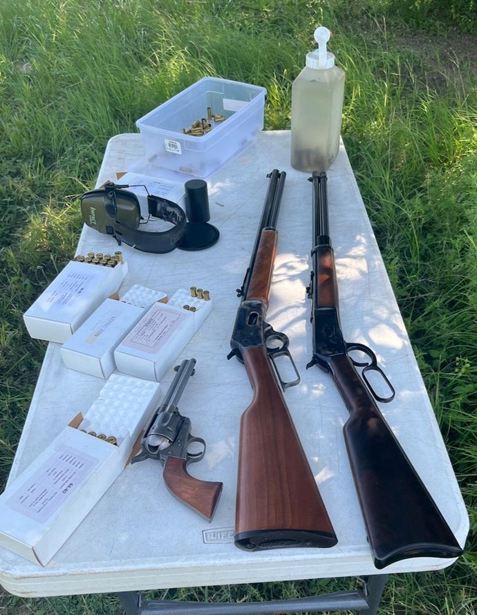

The main purpose of the outing was to compare my new NOE big lube groove 44-40 bullet against my Accurate Molds big lube groove bullet loaded with 35 grains of Old Ensyford 1.5 Fg BP and the bullets lubed with my homemade SPG.
I bought a Rossi 65 1892 carbine last month and wanted to give it a go.  I was hitting 1150 fps with the 1.5 Fg with both bullets, the Accurate Molds actually averaged 1,191 fps.  But the cows had knocked over our shooting bench rubbing against it and trampled it a bit.  So I had to be content with popping a steel plate at 50 yards shooting offhand.  I liked the little Rossi, but my Uberti 1873 Deluxe Rifle is a bit easier to hold steady shooting offhand.
