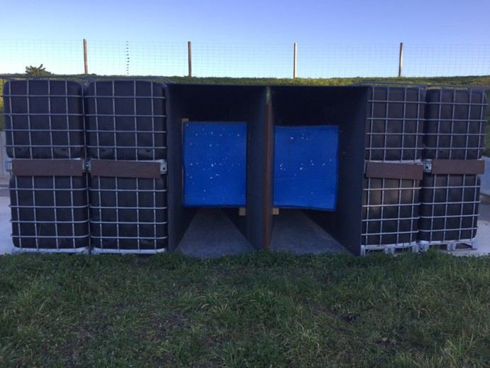

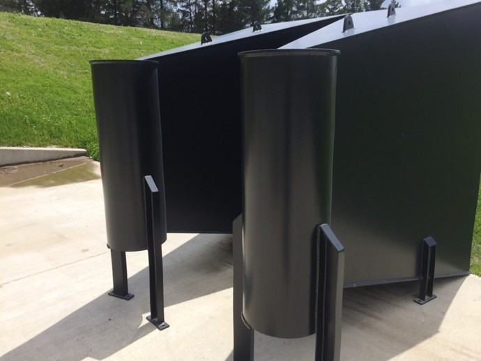

My club has a 200y range with a pair of snail traps.  When a bullet impacts in them they make the BEST sound.  Also great for recovering bullets.  These started life as 40-1 alloy 314299 bullets ex the .303 Brit.

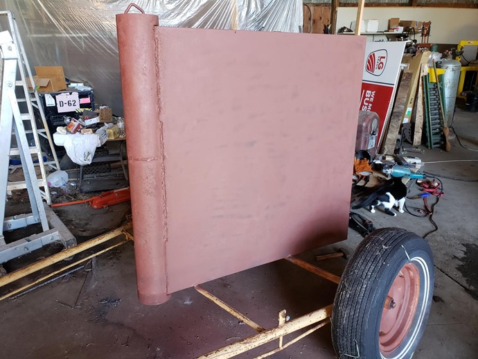

Starting from bottom. Frame and wheels from old grain auger. Vertical pipe was some old well casing. Side panels were actually 1/4 inch thick pieces i purchased because my scrap ones were a little thin. Bucket under the pipe has caught about 75 pounds so far. I thought the wheels would be good to move it to different ranges. The only tricky part was determining the width of the cut to just leave enough space for the bullet to pass through since the lead enters the side of the pipe and spirals around until it drops down. Almost 2 years later and still working fine but now I hate leaving all that nice lead behind at matches when I leave home.

How does that homemade bullet catcher work.  Are there two wings?  Is the wing at an angle to the pipe?  One quarter inch does not sound very thick, I assume cast bullets only?

Yes on 2 wings. I'll take some more pictures to help explain since you're interested. Cast rifle bullets and any pistol bullets are fine. The angles really help spread the energy.

What confuses me, is how do you get the bullets to go into the pipe?   It seems to me you would have to hit it perfectly every time.  Do the two wings meet at the hole?

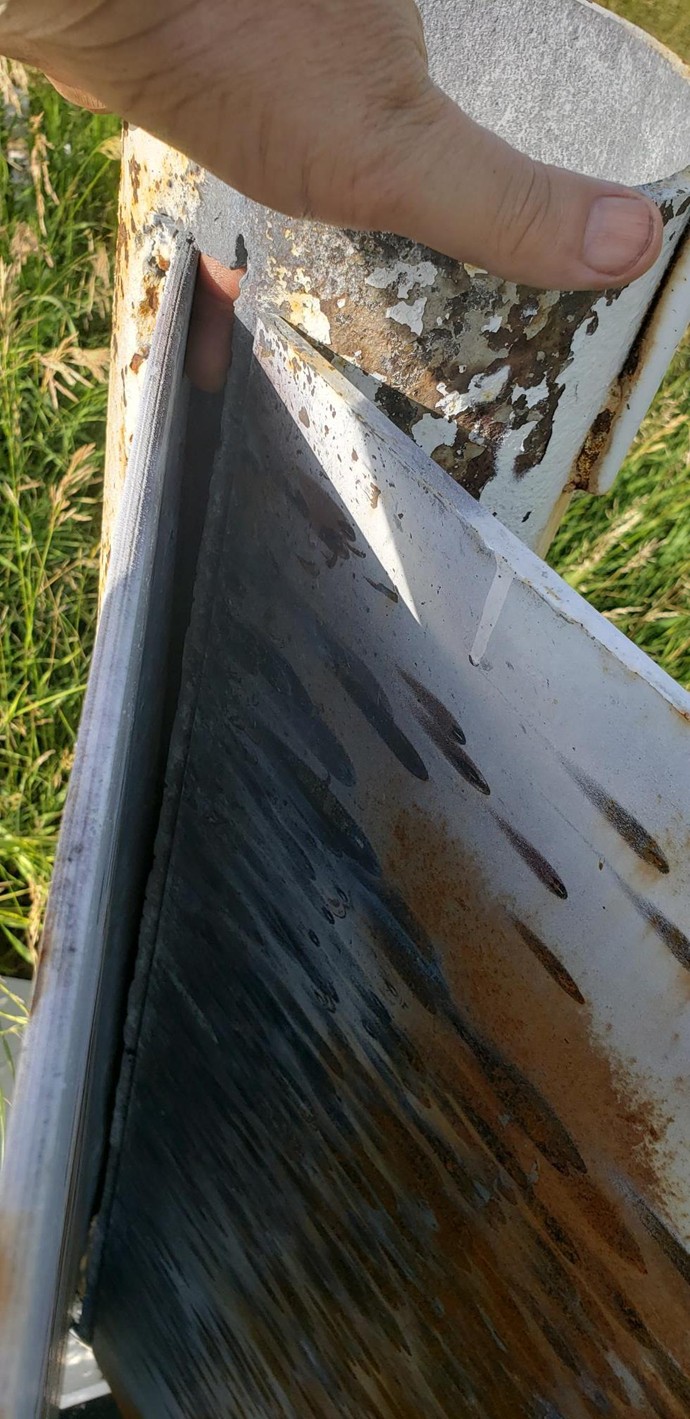

2 years later and a lot of use (and some abuse) and this is the front view showing bullet smears and no appreciable wear. Recent 95 mph winds did undo the polyboard on the front but that's good for this purpose.

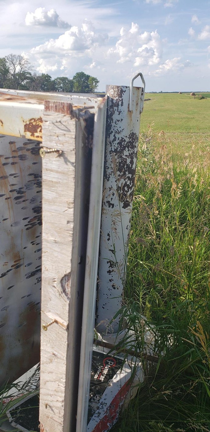

Top of trap showing the finger width slot for the bullets to slide through.  Virtually any shots inside the trap at any angle go in the pipe.

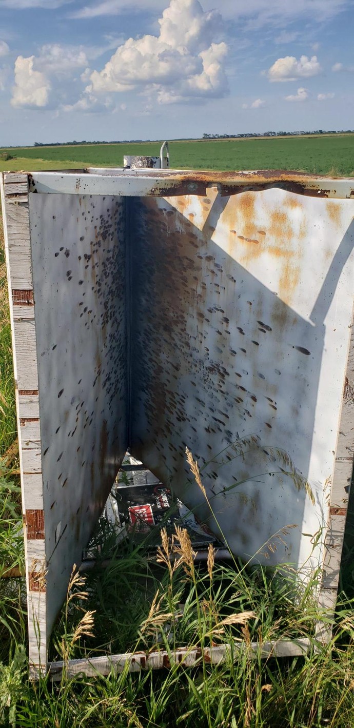

Last set showing right and left sides of trap so you can see how much the pipe is offset to induce the bullets to circle the pipe and lose momentum until they drop out. Some of the braces have been hit but everything has held up pretty well. Plus I can wheel it back into the shop for some minor repairs later.
