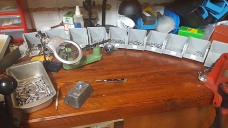

After weighing the bullets, I sort based on bases. (The selected bullets are within +.2/-.3 grains of a median weight.) The sharpest bases go into the rows reserved for record. The slightly rounded bases are used for sighters.
Note: I weigh bullets to find the hidden voids. Any wrinkled bullets are immediately sent back to the pot.

Before GCing and lubing I inspect the bases to ensure the GC shank is fully filled out with a sharp edge. If there is any sprue protrusion, I cut it off. The bullet is then weighed for sorting before GCing and lubing also.

I lay the bullet on its side on a 5 lb lead ingot and use a sharp knife to slice the sprue remains off smooth with the bullet base.
