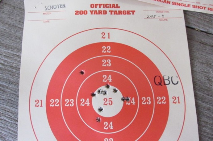

 shot the matches on both Friday and Saturday. The wind varied quite a bit with gusts up to 20 mph. Shot several Schoyen targets each day. It is 10 shots for score reentry match.  The target has a 1.5 inch center and each ring out adds 1.5 inches. i.e. the 24 ring is 3 inches, 23 ring 4.5 inches.
QBC is the quarter bore .25 caliber group.  It is only shot during the Summer match.
On Friday I had 2 good Schoyen targets, 242-5c, and 242-3c.  Shot several 5 shot group reentry targets all bad but turned in the best one.  Saturday shot my best Schoyen target the 245-7c and a few more group targets and turned in the best target of each day, one measured 1.664-inch target.

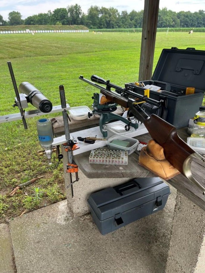

Picture of my bench set up. Ballard with a Ron Smith gain twist barrel, 10 power Lyman STS
https://forum.assra.com/cgi-bin/yabb/YaBB.pl?num=1752590101

Nice Targets and shooting.
I think I have shot from that bench! ha!
