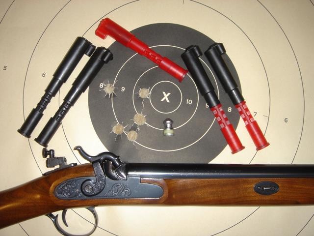

I cast my 50 cal Maxi-Balls out of 16-1 alloy as I push them at 1575 fps over FFFg Triple Seven out of my TC Blk Mtn Magnum.  Pure lead and even 20-1 alloy does not hold up to that acceleration.  The muzzle has a slight taper for loading saboted bullets.  My Maxis drop into the muzzle up to the top drive band.  A rap on the bullet with a short starter seats them into the rifling and then they can be seated with the ram rod.
Here's 6 shots with the first loaded into the dry clean bore, then 5 more loaded out of the speed loaders w/o having to clean between shots.  Target was at 100 yards.  That's the way i used to hunt with it.  Figured if I hadn't got the deer or elk in 6 shots I might as well go home anyway......
