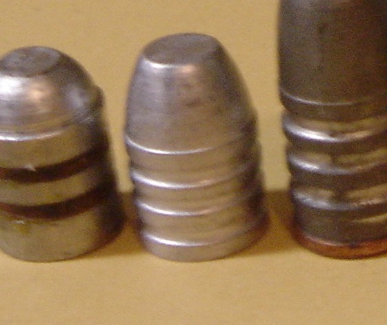

Idahocaster posted this 10 April 2026
I've loaded up three different bullets to try. I have a 230gr round nose that I bumped up. It isn't quite as big as I'd like; I was shooting for .458 but it only got to. 457. We'll try it anyway. I also have the same bullet paper patched to .459, and a 250gr semi wadcutter paper patched to .460. I will let you know how they work once I get a chance to shoot them.
