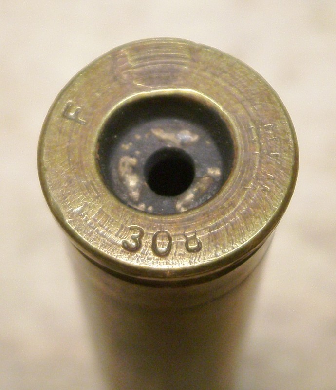

Found in the rubbish at my club.

That load may to a little warm?

Have seen flattened primers before but never like that one.  Primer metal almost looks crystalline, wonder was it really a hot load or is the primer material defective in some way.  Any idea if that was a reload or a factory round.  Would be interesting to measure case head for expansion.
Bud Hyett posted this 14 July 2022
I've done this type of flattened primer several times in my younger days before commnon sense reloading set in. I had a scoped Ruger Blackhawk .30 Carbine that I was trying to make into a ground squirrel gun using 93 grain Norma softpoints. Blue Dot and Herco powder gave some high velocities and spectacular results when I connectedd with a ground squirrel.
The depriming effort was a hard push to start and then the primer judt fell out. Often, the primer pocket was swelled enough the new primer would not stick in the case. These were miiltary cases, the W-W cases were thinner and did not develop quite the pressure.
Fortunartely, common sense struck and I backed off the loadings.
Eutectic posted this 14 July 2022
The pattern may be the reverse of the surface of the bolt face.
Amazing it did not rupture!
Case head expansion is probably excessive but you don't have the original diameter.
You can base it on cartridge specs, but that is not sure.
Is that extractor damage at the top?
"Is that extractor damage at the top?" - That is probably the brass flowing into the extractor cut.

Here is a 308 Win that got fired in a Ruger M77 .270 Win. The rifle survived. We had to beat the bolt out with a #2 sledge. Imagine my surprise when I saw the "308" cartridge ID in a .270 Rifle. This is from my "Stupid Shooter" collection I have acquired with 50 years on a firing line as an Instructor and a R,O. The collection is staggering and the personal injuries I have seen are amazing. Fortunately no deaths but a few came very close to bleeding to death.

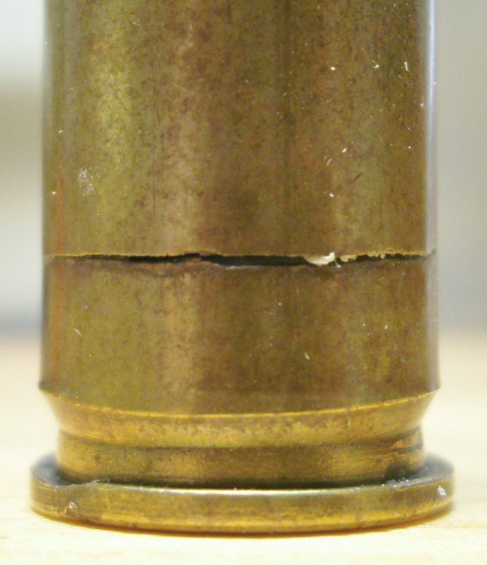

Yes true education is never cheap. One of my early “lessons” was the paper drum of 12,000 military once fired .308 cases. Reloaded 1,000 of them after painstakingly prepping the cases. Went to the range and was firing them in an FN-FAL. After the first magazine I noticed that most of the spent cases were in two pieces on the ground. Those that weren’t had partial head separations. Learned that .308s fired in M60 machine guns with excessive headspace should not be reloaded. When probed the cases all had incipient head separations. Also bought my first collet bullet puller after learning inertia types were meant for a round or two, not 950+. Amazingly no gas leaked and no damage to the rifle. Had my first experience in the scrap metal market too. Remember it’s “cartridge brass” and worth a little more.

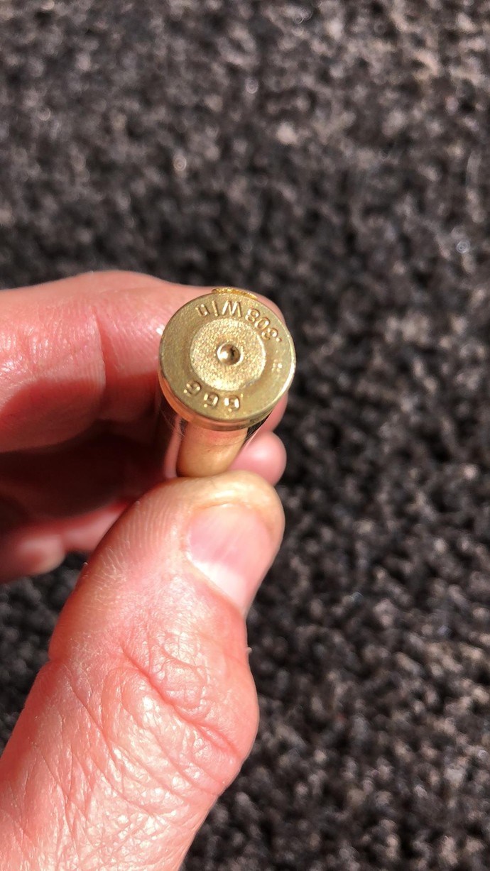

I've never seen a 666 headstamp. At work we have Tank 665 and Tank 667 but no Tank 666. Seemed that there was enough pressure from employees of the Christian faith that we had to remove the number from the tank and renumber all the following tanks in that group.
Maybe not a good idea to use brass with that number?
Dave
JeffinNZ posted this 16 July 2022
Dave
The headstamp is GGG.

After I posted, I looked closer and it did seem like G's not 6's. At the range I picked up a short skinny bullet cartridge and it appeared to be a RP B 78. After closer inspection and some removal of corrosion, it turned out to be a B 18 6.5 Carcano from the Bologna Arsenal in 1918 with the inspectors stamp BP. Cool find in the unfired ammo bucket. Usually its just 22 LR and 30-30 plus the odd bad handload!
