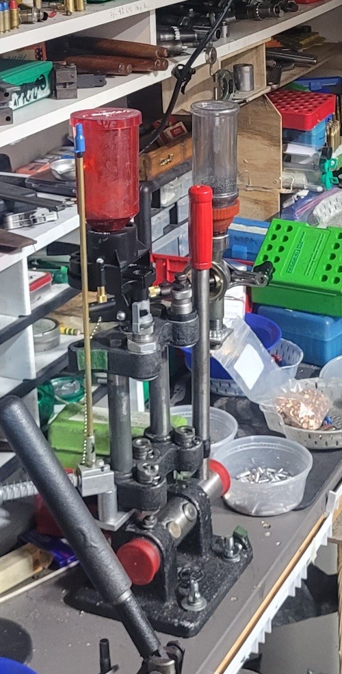

This is a press I picked up a while back in Lewiston. I picked up a Lee Autodisk very cheap recently and added it to the press.I have it set up for 45 auto and 45AR as lately I've been shooting a lot of this stuff in my revolvers indoors. Video shows me loading ten rounds at a good pace but not trying to set records. Video  link shows 10 rounds loaded.Im using the H&G B68 bullet,Its a heavier 68 with added sort of boat tail.
It  takes a bit over 10 minutes to load 50 rounds .if I add the CH auto primer later it might be under 10 minutes?

Now...why are the dies middle, left, right in sequence?
linoww posted this 15 February 2025
back die is FL location because of rigidity and spent primer catcher. Left is where primer rod is.

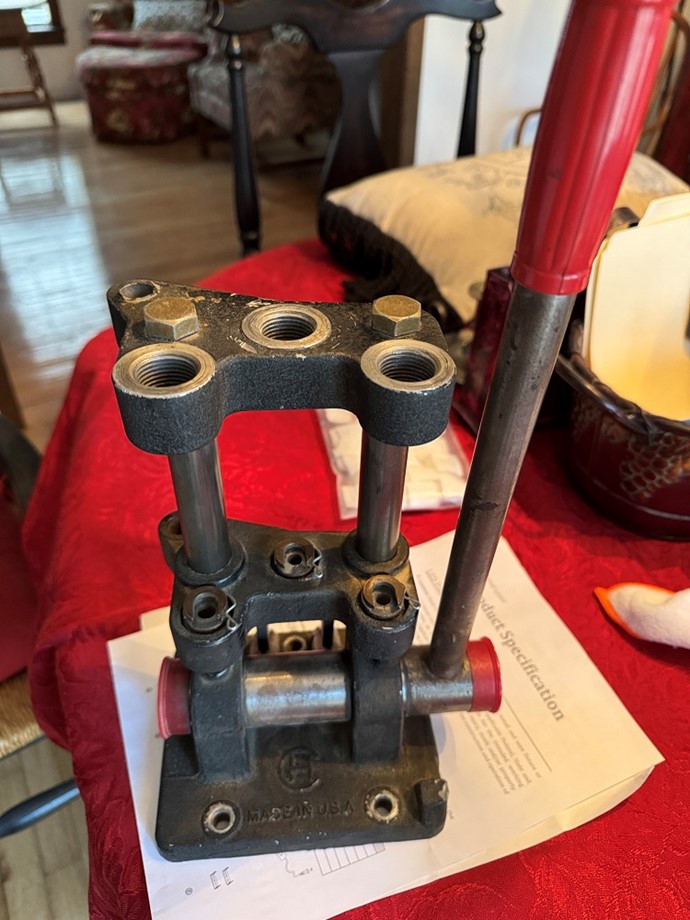

I just picked up a CH 333 Press this past weekend and it's missing the primer arm/nut, any help in locating the part would be greatly appreciated.  Also, anyone have a manual, diagram, ect any information about the press?   I'm recovering from the loss of my wonder wife of 54 years and really need this distraction.   Picked this one up for $50 on FB Marketplace.Thanks ahead of time.

Capt45 posted this 25 March 2025
All I found was parts for the 444.  Will those parts interchange?  Thanks.
linoww posted this 25 March 2025
yes same parts.ive ordered them
Thanks for your assistance.  I'm not a novice but just really getting back into casting and reloading.

yes it can load rifle length cases.
I bought the " Automatic primer" assembly and find it fussy .It's just as fast to just put primers in cup by hand.

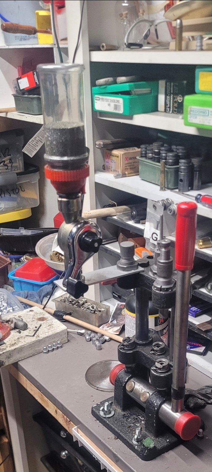

For loading rifle I use a measure mounted like this and it worked great.
