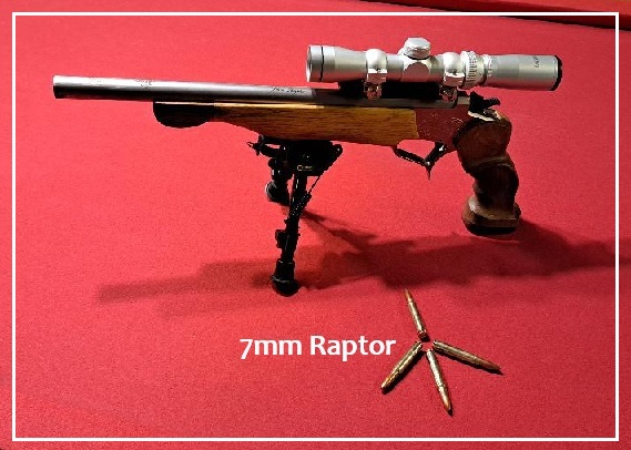

I shoot the 7mm Raptor and it's pretty impressive. Shown here next to it's TCU counterpart.
7mm in 223 and 204 Ruger cases
15
