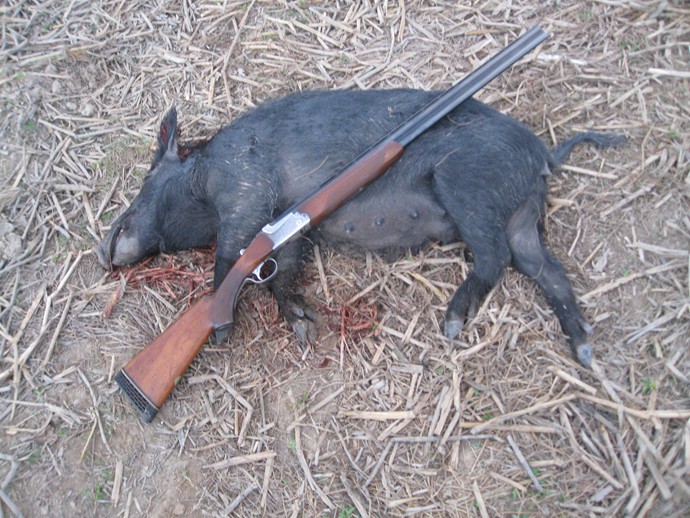

More recently I shot this sow. Range was 16 paces and presentation broadside. The pattern got the head and neck, including one in the temple, so not quite the demonstration I was looking for.
