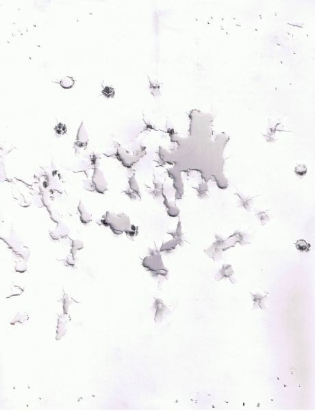

John, Joe Gifford, Russ Harman and I were working on some Ransom Rest test with Ed Harris on his 38/200 articles. The picture below is the common backer for 102 record shots from the same revolver. Just above the center right you see an area totally shot away. This is from 4 of the loads used. The other holes are from 6 loads that did not group well. (Please note several profiles of bullets tumbling.) However, they are almost all low and left. They are not flyers, but part of the normal group dispersion for those loads. They are just the outliers of that load's group. All loads that shot small groups, shot them to the same point of aim. And by the machine, not by hand. My point is that a flyer should be outside of the normal group, not just one on the edge of normal. And you don't have enough data points with 5 five-shot groups to tell you anything. Actually I an surprised that only 100% larger groups are made with that number of groups. .jpg?width=690&upscale=false” alt=)
Assume that shot x and y are distributed normal and we can model distributions of group sizes. We find that with sets of five, 5 shot groups, on average, the largest is 1.91 times the smallest. Recording group size data in EXCEL, the spreadsheet includes LARGEST/SMALLEST for sets of 5 groups-sometimes there are less than 5 groups shot-lack of bullets or??? Anyhow, for the Savage FV in 223, there were 83 sets of five, 5 shot groups fired. The average LARGEST/SMALLEST = 2.103, close to 1.91. This real world DATA suggests to me that the assumption of normality and the 1.91 estimate are supported pretty well.
Modeling group size and monte carlo repeats allow us to tell about anything about groups. We can answer about any question about group sizes.

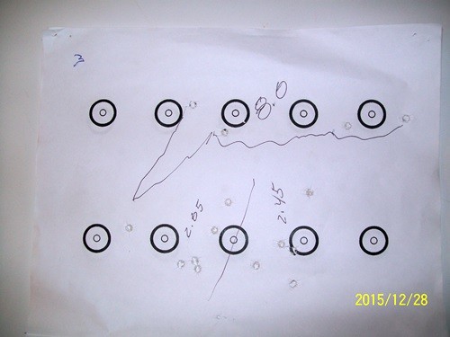

I bought 3# of Titegroup, got the 22-250 Striker shooting with it, easy and fast- then tried to get the Savage 12 FV going yesterday. Last time with the FV; 5, 5.5 and 6 grains produced big ugly groups, too big to measure. Loaded 3.5, 3.9, 4.3 and 4.7 grains and shot them yesterday. 3.5 grains, 3 groups of 2.85", 2.95” and 3.15” 3.9 grains, 1st group missing a shot, it just isn't on the paper. Then 4.0” and 1.7” 4.3 grains, 1st group is an even 8", see the picture 4.7 grains, no measurable groups I went home, unscrewed the varmint weight barrel off the gun and screwed on a 22” light sporter barrel. There's got to be something wrong for the gun to shoot so erratically. This brings up a caveat. In talking about groups and fliers and anything measured and statisticed, the process must be operating smoothly. Groups can be big, but they've got to be sorta round and sorta consistent. Not like mine. My results are telling me that something is amiss, something is causing wild changes in where them bullets hit. I've got to find and fix that before doing much more analysis.
Joe, Have you checked your telescope and your mounts.Mike.
Mike;
Yes, and checked everything else I can think of.
Yesterday, after the very poor shooting, I shot 5 shots of a known fair load into ~1.5". The rifle will shoot some loads fairly reliably < 2", but other loads, Titegroup so far, just wild.
Today I'll take everything apart and see if I can find the gremlin.
Thanks;
joe b.
