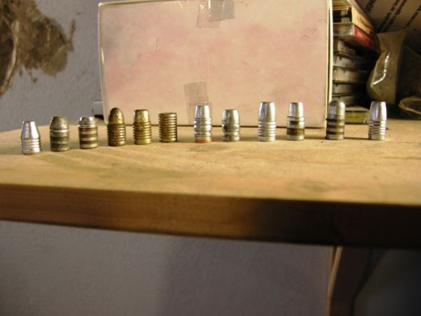

Winter is slowly working its way out of tt hese parts, and soon I'll be able to break out the semi autos without having to dig my brass out of the snow banks.  I'll be working with a Kimber 38 super, and have cast up 2 different Lee bullets to try; one is a 120 gr. TC, the other is a 125 gr. RN, sized at .357.  Am wondering if any CBA members may have worked up any decent loads using either of these bullets in the super.  May be some one can save me some load development time.  But then, that's part of the fun isn't it?  Thanks for the help.
    blackhawk
giorgio de galleani posted this 25 February 2014
The starlings arrived  a few dats ago in the Po valley,usually after their arrival, we have to endure only one cold perturbation before spring weather. The snow has meted. I am loading buckets of  9x21 and 38 super in my 911 clones, an STI Spartan and an Auto-Ordnance Thompson pistol-, I use both the Lee molds ( six cavity)you have. I use old wheel weights ,range scrap and a mix of plumber's lead with a little lynotype . The round nose passes through an RCBS lubrisizer,The TTL  is lubed with XLOX from LESTUFF  and a Lee push trough die. Quenchig them all in cold water ,directly from the mold. And sizing bouth to 357 .. I use air cooled bullets in the same  for light Cow-Boy Shooting 38sp loads. My 9mm bore auto pistols lead horribly with soft alloys. I have normal issue recoil springs, because with reduced power springs the pistol won't shut the slide reliably . I use Granular Cheddite Grossa,which is a single base shotgun powder ,similar to Red Dot and PB in relative quickness. A little less than 5 grains in the nine ,more in the 38 super. Any fast  economical shotgun powder made for 30- 32 grams of shot in the 12 gauge will do.  It must meter  reliably through  a Lee  powder disk measure. All are loade in a Dillon 550 with 4  Lee dies ,with factory crimp. I sit in a position who lets me spot a double charge in the hulls. Safety first.  I use the lowest weight that reliably cycles the action . You have to do a lot of experimenting and load development in your gun.That is half of the fun. The 38 super accepts  38 revolver bullets with any nose configuration and they reliabily cicle the action , consider what your goals are you have a GREAT lot of work to do, I should say an endless pleasure.  I use a velocity around 1100 fps wit a power factor around 130 that is correct enough for fun shooting at steel plates. This combo shoots decently and does not lead the bore and I can shoot over 150 rounds without cleaning.   My goals is  economical fun shooting at reactive targets ,with minute of steel plate accuracy without leading and dirty pistol stoppages.

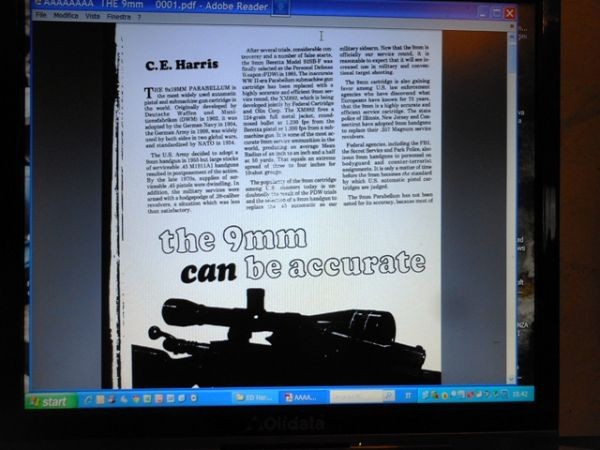

Just to give you some more work, I have re read an article on  one of the Wolfe's magazines , the author is Ed Harris, about the 9 Luger with cast bullets.
He prefers heavier bullets for lower pressures and better accuracy with cast bullets.
Perhaps you could at the clever designs of the aluminum gang molds made by Accurate Molds, they are well made ,a lttle more expensive than Lee's.
And what a pity that Ranch Dog Molds is out of bisness, clever designs and low cost................................
A never ending research indeed.
giorgio de galleani posted this 03 March 2014
I try to post Ed's story on the 9mm
To view the file right click on the file name select <Save target as> change the .txt on the file to .pdf and save.  You will then be able to view it where you saved it to.
Mike CBA Webmaster in training
PS: I have the software people working on the problem
Ken Campbell Iowa posted this 03 March 2014
can't interpret the pdf code; my adobe reader didn't wake up. sigh.
Vassal posted this 03 March 2014
I didn't realize contemporary Italian was so unique!
THE damned PC machine has betrayed me.
