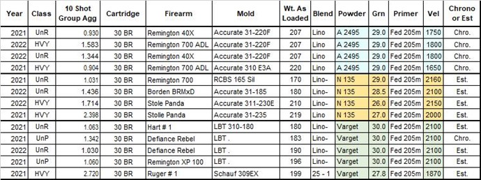

For what its worth this is the 2021 and 2022 Nationals data.  In total there were 19 competitors those two years.  Of the 19, 16 shot three different powders; N135, Varget and 2495.  Bullet weight ranged from a low of 170 to 220 grains with the average being around 200 grains.
Not sure if this will help but here is what the shooters put on the data sheets for 2021 and 2022 shooting those three powders chambered in BR30.  Good luck and if you have time give the velocity, weight of bullet you're using.  That and on what platform. Again good luck, Bill C.
