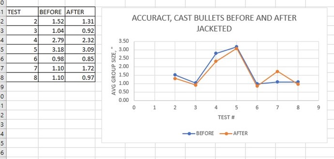

John Alexander posted this 2 weeks ago
This thread started with the question by max503 – does JB fouling degrade CB accuracy?  It has wandered a bit with detours for cleaning elixirs and target cameras but I think the original question is worth working on.  This warning of JB fouling is another conventional wisdom “we all know” that is supported by only anecdotal evidence as far as I can find – a very weak stick. In a 1-29-19 post I reported that my first try to test this old rule was questionable because of bore leading and said I would try again with bullets that fit better to avoid leading.
Our local range opened yesterday after a two-week closure by a 30” snow and today I shot another test. The CB load was a different lot of the 85 grain 25:1 spitzer bullets, Mag Tech SR primers, 6 grains of Blue Dot giving approximately the same MV as the earlier load with the same Tikka 223 rifle and no evidence of leading this time. The twenty rounds of jacket bullets were from the same box of Herter 55 grain wonders with the same load as before.
CB 5 round groups starting with a clean bore. -- .97, .84, 1.26, 1.08 moa  -- Average 1.04 moa
Jacketed 5 round groups – 2.20, 2.48, 1.34, 1.76 moa – Average = 1.95 moa
CB 5 round groups after JBs -- .46, .80, 1.50, .92 moa – Average = .91, moa
For a person who believes that small differences in even two groups prove things (Joeb’s statistics be damned) this “proves” that a bit of guilding metal fouling improves accuracy of cast bullet loads by 14%.
But usually such conclusions are jumping the gun.  It seems to me that these results give a hint, but not much more than a hint, that a bit of JB fouling may improve accuracy (in complete opposition to what most of us have been told). Consulting Joe’s tables this 14% improvement for eight 5 shot groups has a confidence level of much less than 70% -- far from certain. As usual, more groups need to be shot if we want to be more certain.
It would be interesting to see this experiment replicated with other calibers, alloys, muzzle velocities, increased JB fouling, etc.  I hope someone will jump in and try it.

TEST #6
John Alexander posted this yesterday
Finally got to the range today (March 29) for another try at the accuracy of CB after fouling bore with JB compared to accuracy from clean bore.
Load was the same as before except for a different lot of the same 80 grain spitzer bullets.
Accuracy of four 5-shot groups of CBs starting with a clean copper free bore .84', .70" .88", 1.50" -- Average 0.98"
Accuracy of four 5-shot groups of JBs 1.66, 1.70", 3.00", 1.64" -- Average = 2.0"
Accuracy of four 5-shot groups of CBs .78", 1.24", .42", .96" -- Average = 0.85"
Accuracy of the cast bullet loads were 13% better after fouling the bore with twenty rounds of jacketed bullets.
This result is similar to the previous four similar test results all showing improved accuracy after fouling the bore with 20 jacketed bullet . Groups shrunk by between 13 and 19 percent.
This is of course the exact opposite of what we thought we knew.  Every experienced CB shooter knows that jacketed bullet fouling ruins cast accuracy because that's what we have been told.  But when five series of groups by three different shooters using five or six different loads all show that 20 rounds of JB fouling improves accuracy an open minded shooter should begin to question the rule that you can't mix cast and jacketed bullets.
Of course these tests so far don't cover all the possibilities.  What about the fouling from 50 jacketed bullet loads, 100 loads, 200? Surely gross guilding metal fouling, the kind that we have been told degrades JB accuracy would also degrade CB accuracy. We can guess but at this point we don't know that either.
Anybody have a rifle not cleaned since the last prairie dog shoot that you have a cast bullet load for? Shoot a few groups before cleaning and a few more after cleaning and see what happens.
TEST #7
joeb, 4/3/19
M10 Savage, M110 308 HV barrel,
314299, .3095, Lyman Super Moly, 15/A#9 Fired 30 before, 25 after.
Hornady 130 gr sp, 43/IMR4895. Fired 30.
100 yard 5 shot group, inches, in order shot;
Clean barrel, 5 314299 sighters, then
1.625, .8, 1.3, .925, .85,AVG = 1.1 then
130 Hornady, 1.6, .85, .8, 1.4, 1.825 AVG = 1.283, then
314299, 2.9, 1.8, 1.65, 1.1, 1.15, AVG = 1.72
TEST #8
John Alexander posted this 4/6/19
I fired another string in the before and after jacketed fouling test yesterday (4-5-19).  The cast bullet load was the same as before but for the jacketed load I dug out some longer bullets (Sierra 69 grain HPBT Matchkings) in hope of reducing the jump short jacketed bullet must make in my Tikka with its eroded throat – same powder and primers. Procedure was the same starting with a clean bore (Sweet’s solvent until no blue green patches) and no cleaning during the test.  One fouling shot was fired before each of the 20 shot cast bullet strings. Tikka 223 rifle and no evidence of leading.
CB – 5-shot groups starting with a clean bore. -- .1.36, .88, .50, 1.64 moa -- Average 1.10  moa
Jacketed 5-shot groups – 1.20, .90, .76, 1.28 moa – Average = 1.04 moa
CB 5-shot groups after JBs -- .98, 1.10, .94, .84 moa – Average = .97, moa
Reduction in CB group size after jacketed fouling = 12%
The longer JBs which were seated just off the lands shot as accurately as the CBs.
Cleaning the bore afterwards with Sweets produced patches with a little blue green color.

4 5-shot groups with Sierra 69 gr MK and 18 grains of Reloader 7 - .98, 1.06, .82, .90 moa – Average = .94 moa.
One fouling shot.
4 5-shot groups with same CB load as before -.72, 1.14, .96, 1.24 moa. Average=1.03 moa
Clean bore with Sweets, 30 minute soak.
One fouling shot
4 5-shot groups with same CB load - .40, 1.34, .98, 1.68 moa. Average = 1.10 moa.
Summary
This test #10 again failed to show that JB fouling degraded CB accuracy.

joeb33050 posted this 14 April 2019
Is it possible to get enough jacketed bullet fouling in a barrel to degrade cast bullet accuracy?
We don't know.
Will shooting cast bullets in a jacketed bullet fouled barrel remove that fouling?
Maybe-Probably
Will a slightly-moderately jacketed-bullet-fouled barrel degrade cast bullet accuracy?
Probably not, at cast bullet accuracy averages around 1 moa.
John Alexander posted this 14 April 2019
I think Joe's remarks about what we know so far are about right.
I also think that it is pretty obvious that the dire warnings that a bit of JB fouling (up to at least 20 shots) degrades CB accuracy would be pretty hard to support in spite of the fact that we have been hearing them as absolute truth for at least 70 years.
