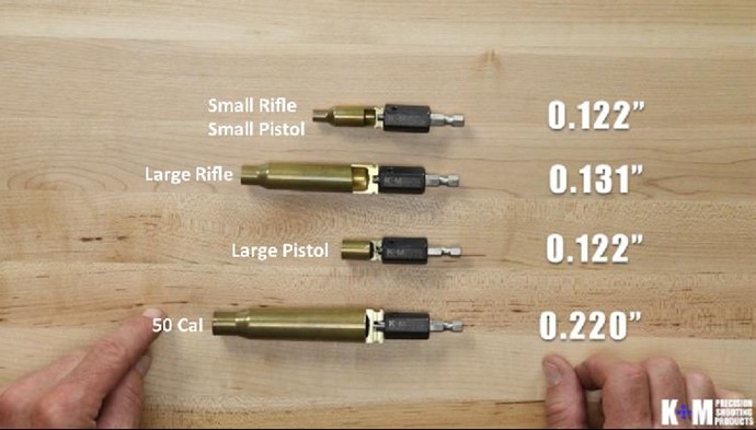

  • Seven and Rick was right.  Buy the K&M Uniformer. It comes adjusted for the size primer you'll be using. LR comes in at .131 and all of the various brass I have runs .125 to .129.  As shipped the K&M will clean up all of my brass.
  • The K&M Uniformer has a quick release 1/4" hex shank for a hand drill.
  • The K&M Uniformer has a wide face that covers case head. The Burstfireguns has a smaller diameter and it marred the case head.
  • You can use that same tool to wipe the pockets clean when reloading.
  • The tool is adjustable but K&M recommends that if adjustment is needed, contact them before you DIY.
  • K&M has a video that even I could understand.
