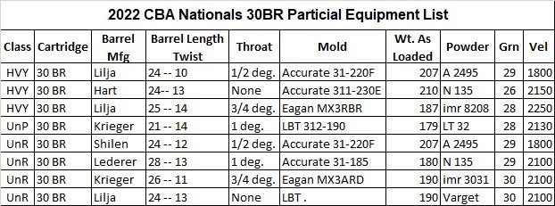

I'd call Dave Kiff at Pacific Tool and Gage and have a conversation with him.  He'd have an opinion on the neck cut and if you send him a couple dummy rounds he'll probably be able to work up a drawing for you to look at.  But I would recommend designing the throat to something other than the 311299 look alike.

The results from the CBA Nationals will give an idea what others are using. There's a couple Spitizer with most others either Egan design or the straight taper from Accurate.

A little insight into two lines of the data chart supplied by Wm Cook: - HVY Class Hart 24" 1-13" twist barrel is a .331" neck 30br - UNR Class Lederer 28" 1-13" twist is also a .331" neck.
Both rifles belong to my father. There are multiple 30BR's in his possession, and all of them are .331" necks. They all shoot very well. He does all of his neck turning based off of a .312 bullet diameter, with the ability to run a .310 in the same case just a little dirtier.
You will find that most 30BR's will prefer a borerider or custom bumped/tapered bullet to match the throat. We have a few bullets that will shoot straight out of the mold, but they're odd to find.

Hey Jeffery, one last question.  What does "none" mean where it shows the throating on that HVY Class Hart 24" 1-13?
