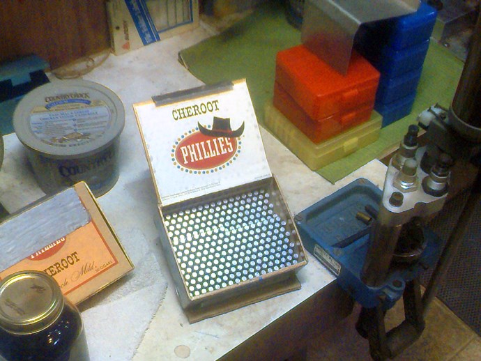

... as a dedicated plinker,  my standards are perhaps ... ahem ... a little lower than dedicated competition types ....
...so bet you would think i go for speed ::  but NO !! .... i do what tickles my ...funnybone ... i like to ladle pour .... i use a b&m 17-second-per-charge  powder measure ... i uniform primer pockets on my lathe ... because i like to hear it run ( color me weird ) ... i use my 1958 herter's #3 press ..... even though i have a bonanza rig .... and a lee classic cast ...
i prime  single-dingle in my bonanza because i can talk to each individual primer ( "" go baby, please go bang when i pull the trigger !! "" ) ... even though i have 2 or 3 lee hand primers ... an rcbs bench single primer ... and oh ... an rcbs strip primer production bench mounted priming extravaganza ...  i use unique because that was the first powder i bot when i was 15 years old ... that and because you can't buy No. 80 anymore :: the worlds best ever gun powder ...
... and even worse, i load cast mostly for old nostalgic guns that i think  actually greet me with a happy grin as i take them from their hidey-hole out into the sunshine for a delightful day of exploding soda cans ...  and lately giant groundhogs ...( marmota plinkeratem ) .....
there ... i confess .... oh, i like to listen to coyotes in the evening ... and oh, i don't have an ar-15 yet ... sigh ...
