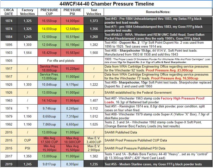

I do know Winchester advised not to reload their HV factory, loads but that was pre- WWII using semi-balloonhead brass. I am not surprised similar issues may be encountered with WW brass. Using such loads in the Marlin 1894CB, I do get case stretch and have to trim after several fired re-loads, however, I am using the stronger Starline brass. I was able to purchase a batch that was 1.300" and they have stretched as much as 1.310" before I sized back to 1.300". There is certainly some thinning going on in there but I have yet to cut one open to check. Fired HV loads from the Marlin will not chamber in my revolversor my Marlin 1889, so the chamber is a tad oversized at the base.
No issues yet with separations but I am keeping an eye on it. It did catch my attention when he mentions getting customs die made for such chambers.
Many report scatter-gun results with such loads but I get excellent results at 265 yards with the 94CB with such loads.

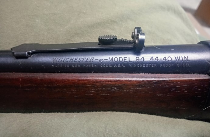

Savvyjack thanks for posting the article, good read. The reference to Philip Sharpe's book reminded me to go look for my copy. I haven't looked at it in probably 40 years, kinda forgot it was on the shelf. Good reference for the 44-40 and quite a few other cartridges to use for reference with others like the older Lyman books and others.
Now I have to check my old Winchester 92 to see if it's nickel steel or not. Would have to keep loads well separated from loads for my Colt Lighting pump.
Intreasting thread, thanks.
