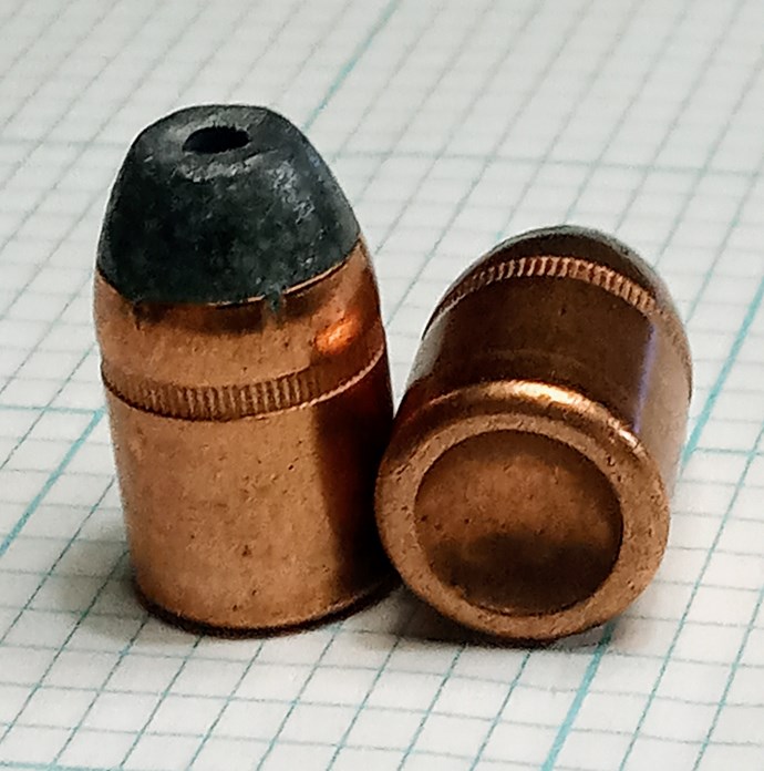

I bought a "crap load" of Winchester .430" diameter jacketed hollow point bullets with the cupped base, skived jacket and small HP cavity stabbed into the generous "glob" of exposed lead.
4227 data so far from Larry with this bullet has 18 grains for 19,200 psi and 19 grains for 20,300.psi.
I have loaded some at 18.5 grains to test in my S&W 544, Ruger Super Blackhawk with .44-40 cylinder and 1894S Marlin. If they shoot well I will try in my 1920 Colt New Service.

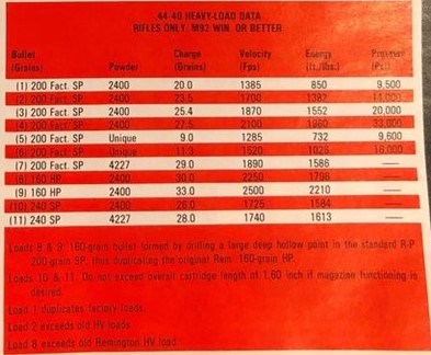

Here are the only two 44-40 test results I have with a jacketed 240gr bullet.
Test#/grains/bullet weight/bullet/velocity/psi/est. cup/AOT/target#/notes
  • 67/25/Reloder 7/240 DGHP/Speer 4455/1,350/15,248/18,024/36/223/Case Capasity
  • 70/22/IMR4227/240 DCHP/Speer/1,400/20,547/24,287/50/229/Typical 4" Group @ 100 yards
According to the 240gr load chart in the aforementioned article, there is room to spare, but the pressure could be much higher.

I am not looking to push this as a rifle-only load not useable in the revolvers defeats the purpose. My reasoning is that my post-1920 .44-40 New Service revolvers are heat treated and that the modern Italian single-actions are all proofed to CIP and are designed to handle standard-pressure loads in .45 ACP, so I told Larry to use 20,000 psi as a loading limit in his .44 Magnum Contender test platform. The powder capacity of the .44-40 using Starline brass is about 6% greater than the .44 Magnum, which will lower pressure a little and give a cushion to fit nicely into that ".45 ACP" pressure envelope.
My expectation is that velocity of this load should be 850-880 fps from a 5 inch revolver, depending upon cylinder gap and probably 1050-1100 in the 20-inch carbine.  The exposed lead should rivet a little at revolver velocity, maintaining penetration, while starting to expand.  My hope is that at rifle velocity the ja. cket will peel back a bit and mushroom over .50 cal., without the "parachute" effect of dramatic expansion, which reduces penetration. Reliably penetrating over 30 inches of water jugs is expected. Probably closer to 40!

For the 240gr JSP load for the 44-40 strong revolvers, it looks like a 21gr charge or less of 4227 will be needed (2400 was not tested by me.). Hopefully we can compare that result with Larry's and get a medium for the strong revolvers.
  • The 25gr Reloader 7 charge gives original 200gr Winchester 44 WHV 18,000 cup pressures.
  • The 22gr 4227 load gives 24,287 cup pressure results
  • The 28gr article load should give excessive high pressure results. (33,000 cup range)
From the article, they did not hesitate to push 33,000 cup pressures for the 92.
