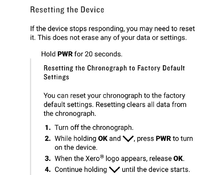

The first day I wrote off as a learning experience and (again) read through the manual.  The second day it recorded 53 shots in a row, just like a clock ticking, when it stopped reading. It was at the start of a 10 shot string when it stopped.  I didn't notice it until I had finished the group. It wasn't location because after the first string I used a magic marker on the bench so I knew where the Garmin should be placed.  After every shot string you have to pick it up, end the session and start another.  That means it must be repositioned every shot string.  And it shouldn't have stopped reading since it had just recorded 53 shots (10+ 5 shot groups) in a row.  Right??
After re-reading the manual I'm starting to think that the unit needs to be reset to factory specs to delete all the data being stored.  I didn't come up with that on my own, Garmin recommends it as part of their trouble shooting recommendations should it stop reading..  The software is designed to dump the oldest data when you start a new session.  I'm guessing that its on data/sensory overload.  I'm shooting again Monday and I'll do a factory reset and see how things work.  Below you'll see the screen shot on what to do when your Garmin stops recording.

Aaron i haven't found the Garmin frustrating to use at all and have had absolutely 0 problems with it. At the match I attended 2 weeks ago I walked down the line setting it on people's benches requiring only pointing it at the target and it picked everything up. If the chrono being used by Bill was a range lend out maybe the memory was full and that's why it quit working. The Bluetooth software admittedly could use some work but it does work.
