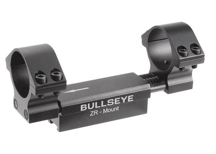

I have a FWB 124D, bough my first one from Beeman's, in 1974, with a Bushnell Scopechief iv with the bar on the bottom, shook the lens out in 1990, factory fixed it still using it, according to Beeman's the scope was modified for springer air rifles
of course the way it is mounted sucks and has to be re tightened about every 100 shots or so, scope slides on the rifle, locktite and such doesn't work
looking for a solution I come across this, in a recommendation from a poster on the GTA site, of course it looks like unobtanium

I had a ZR mount.It was a POS and didn't return to battery consistently.

4060may posted this 19 September 2024
linoww
still have the ZR base
want to sell it

I gave  the ZR to a buddy who had the same issues and he threw it away.

MIZUGIWA 1 inch/30mm Rings 11mm Dovetail High Profile Scope Mount,w/Stop Pin, Zero Recoil Base Compensation https://a.co/d/1L44TSS
