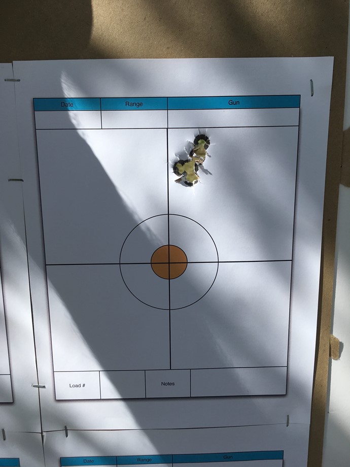

Here is the target at 15 yards with the 4.0 grains of Bullseye Load:

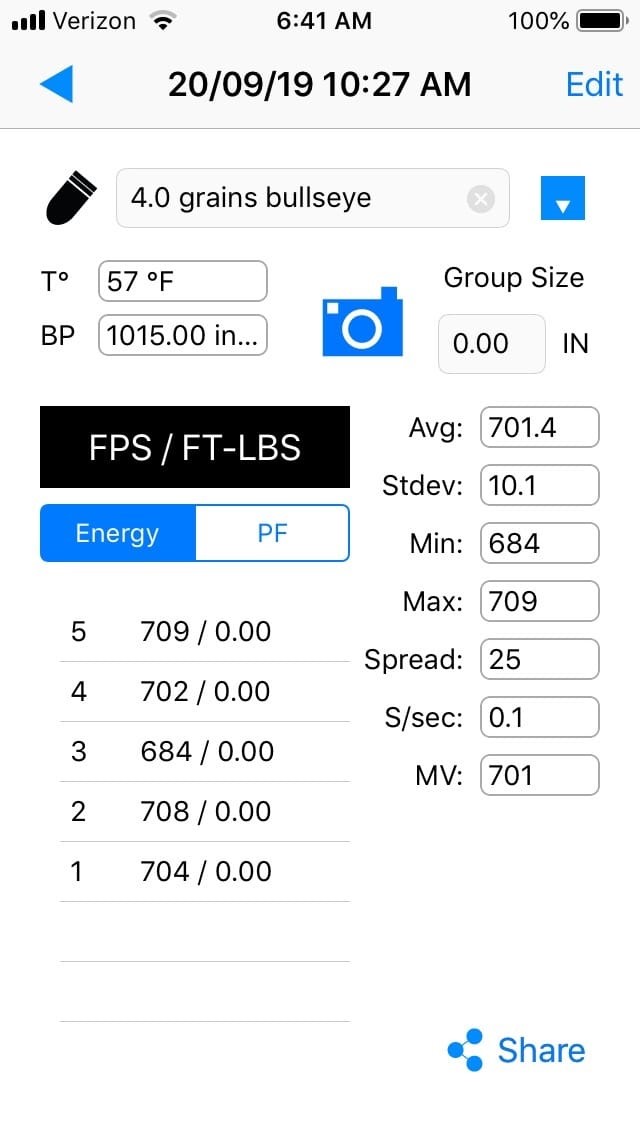

And the Chronograph Data:

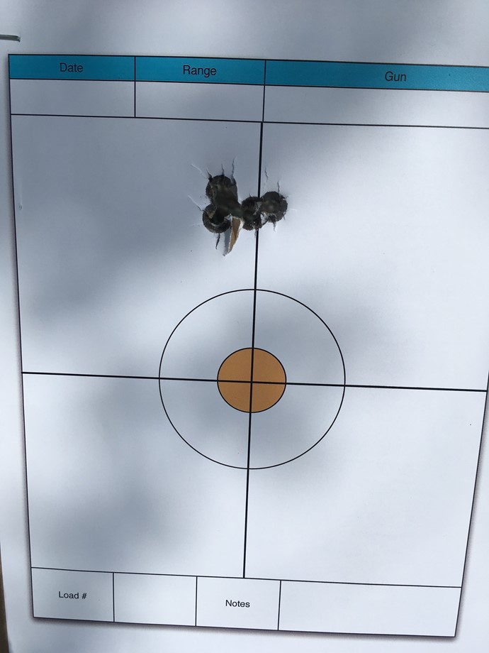

Here is the 4.8 Grain Bullseye Load target:

The distance to the target was only about 15 yards, but my purpose was just to chronograph the loads.  This was the first time I had tried a cat sneeze load in my trapdoor, so I was surprised it shot as well as it did.   I was aiming at the center of the target with sight in the lowered battle position.
It was also a surprise to me that the SD with the 4.0 grain Bullseye load was only 10.1 fps.  That is a big case with a tiny charge of Bullseye powder with no filler.
These loads are quiet, absolutely zero recoil and a hoot to shoot.  I shot the rest that I loaded at an AR-500 plate about 40 yards away and managed to pop it almost every time.  Which is a minor miracle, considering how teeny tiny and fine the sights are on my rifle.

BTW - nworegonman, I wanted to mention that the chronograph screen captures I posted were from the Caldwell chronograph we were discussing in your other thread.
